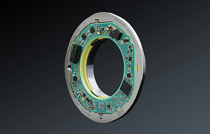

The KCI 120 Dplus dual encoder from HEIDENHAIN provides motor feedback and position measurement in a single device. By measuring the position downstream from the gearbox, the KCI 120 Dplus compensates for design-related errors in dynamic, highly maneuverable robots. Articulated robots with a serial architecture, for example, may contain up to six axes, each of which affects final accuracy.
  • Each axis is driven by a servomotor through a gear system that is susceptible to zero-position error, reversal error, and joint elasticity
  • Applied forces and dynamic effects from the machining task may further limit positioning accuracy

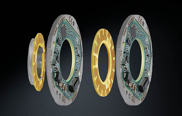

KCI 120 Dplus: three sizes for perfect integration
In order for the two-fold functionality of the KCI 120 Dplus to be used in as many applications as possible, three versions of the dual encoder are now available. The central scanning unit and two separate disk/hub assemblies are thus suited for various hollow-shaft diameters and installation dimensions. That way the KCI 120 Dplus from HEIDENHAIN, which can be integrated very easily, always offers the same functionality no matter how compact its dimensions are.
The purely serial EnDat 2.2 interface with functional safety can also be used in safety-critical applications such as human-robot collaboration.

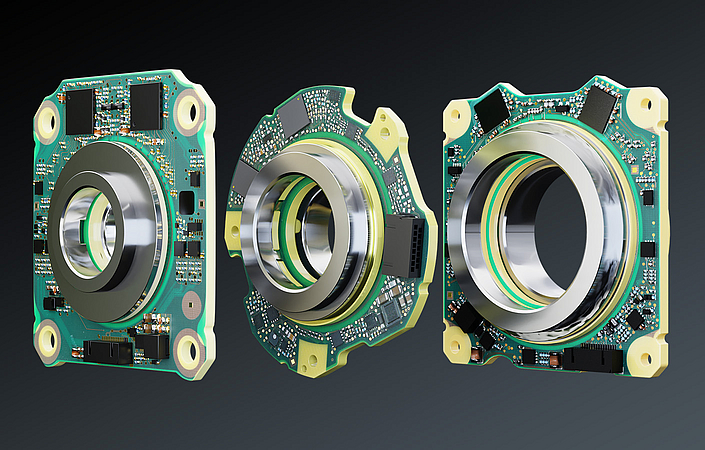

KCI 1319 and KBI 1335 servo encoders for compact robot motors
The KCI 1319 and KBI 1335 rotary encoders developed by HEIDENHAIN for robot motors are inductive encoders that consist of a scanning unit and a screw-fastened circular scale or alternatively a disk/hub assembly for seating onto a motor shaft.
‍Your benefits:
  • Very compact design and low weight
  • Immunity to contamination and magnetic fields
  • Easy installation with wide tolerances
  • Safe and secure physical mounting
  • Safe data transfer via EnDat 2.2 with functional safety
  • Overload protection with an external temperature sensor is possible
